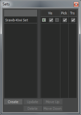

Creating a set
  1. Select an object in the Scene browser or the Viewer window. Ctrl-click to select multiple objects.
  2. Click Create in the Sets window.
    The new set is listed in the Sets list. If no objects are selected, an empty set is created.
    A set is added to the Sets list.
