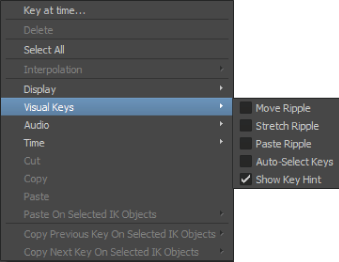

The options in the Visual Keys menu let you set options for visual keyframes on the Dopesheet timeline and the Action timeline.
Visual Keys menu
| Option | Description |
| Move Ripple | Pushes deselected keys horizontally when offsetting a keyframe or keyframe region. Disable to keep deselected keys anchored when offsetting (default). |
| Stretch Ripple | Moves deselected keys horizontally according to the stretch when stretching a keyframe region. Disable to keep deselected keys anchored when stretching (default). |
| Paste Ripple | Moves deselected keys horizontally when pasting keyframe regions. Disable to keep deselected keys anchored when pasting (default). |
| Auto-Select Keys | When activated, visual keyframes closest to the current timecode are automatically selected. |
| Show Key Hint | When activated, certain keyframes display with color. Keyframes set in the Full Body character keying mode display with a red tip. Keyframes set in the Body Part character keying mode display with a green tip. Keyframes set in the Selection character keying mode do not have a color. See Keyframing a Control rig. When disabled, all keyframes look the same, except for keyframes set in the Story window. Note: Keyframes that are completely colored are related to clips in the Story window.

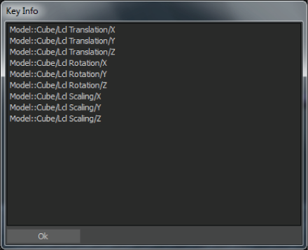

When you right-click a keyframe, the Key Info option displays in the context menu, letting you open a Key Info window. The Key Info window displays information about the selected keyframe.
Key Info window
