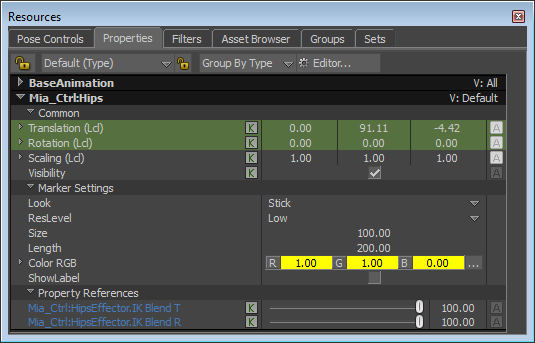

Properties of an FK effector for the hips. A. Two reference properties for the IK effectors of the hips are also listed

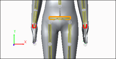

FK effectors on the hips and wrists display Reach Outline visual feedback for hidden IK effectors
