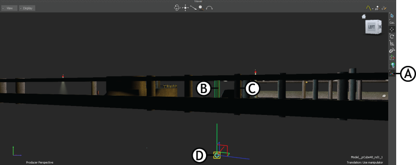

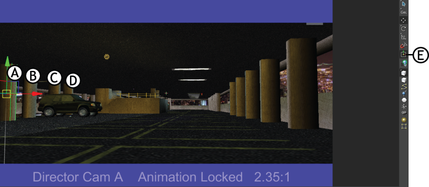

Camera view of a parking lot scene in Viewer window A, B, C, D Pillars E. Temporary Pivot Shift icon

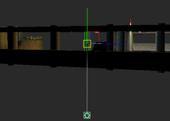

Parking lot scene rotated to locate the pivot of pillar C A. Pivot Mode B, C Pillars between which the car is parked D. Offset location of the pivot of pillar C
In a virtual production environment, if the director want to immediately reposition all the pillars (A, B, C, and D) on the scene, then it is time consuming to rotate the scene, locate the offset position of each pillar, and drag them to the center point of each pillar, before repositioning them.

Notice that the coordinates of temporary pivot and the line that connects the offset location and the temporary shift to the bounding box center appears dotted. This specifies that the shift from offset pivot location to the center of an object is only temporary.

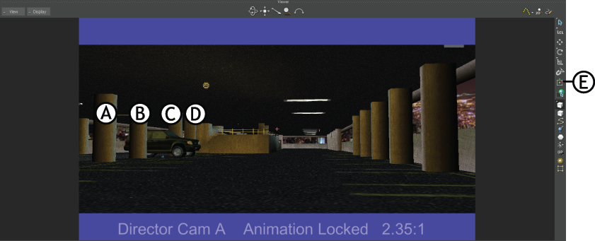

Parking lot scene A, B, C, D Pillars moved backward E. Temporary Pivot Shift tool active
By default, the temporary pivot appears in the translation mode (T). You can change to the rotation and scaling modes using the R and S keys, respectively.
