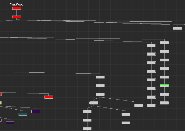

The contour of the Mia:RightFoot node is highlighted in green
This node represents Mia’s right foot and is to be used as the matching object.

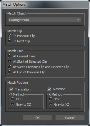

The Match Options dialog displays.
The last clip vector moves to match the previous clip.
Mia runs, turns, then is thrown forward. The jump in the animation is gone.
