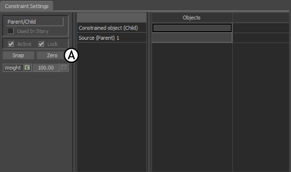

To lock the position of a constrained object:
- In the constraints setting for the appropriate constraint, make sure the constraint is activated.
- Activate the Lock option. This locks the position or rotation of the constrained object.  Parent/Child constraint A Lock option
To reposition locked objects:
- Disable the constraint’s Active and Lock options.
- Transform the object and click Snap
- Activate the lock Option.
