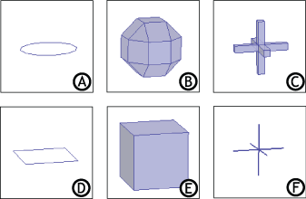

To change the appearance of IK or FK effectors:
> Add to Selection > IK or FK.
IK effector marker types A. Circle B. Sphere C. Hard Cross D. Square E. Cube F. Light Cross
Sphere is the default marker type.
The Hard Cross and Light Cross types display the markers as thick and wireframe crosses, respectively.
Selecting None hides all the effectors in a Character in the Viewer window.
