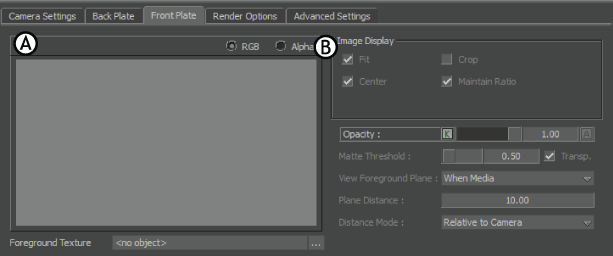

Front Plate pane
Similar to the Back Plate pane, the Front Plate pane lets you select a texture (containing either an image or video clip) to appear in the camera view, but for the camera’s foreground plane.
The Front Plate plane is a separate plane used only for projecting images or video clips. The size of the plane matches the camera’s viewing area and remains a part of the camera’s view, even with the 2D magnifier, and the Turn Table options.
Front Plate pane A. Image Preview area B. Image Display settings
