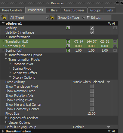

To display a Transformation pivot of an object:
Property Resources
Transformation Pivots Display Options
The default Pivot Visibility is set to Visible when Selected.

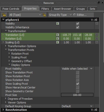

Show Scaling Pivot visibility option enabled
Although the Show Scaling Pivot visibility is enabled, the pivot may not be visible in the Viewer window as it may be hidden by the object.

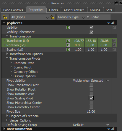

Transformation Scaling Pivot resized

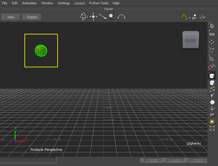

The Scaling Pivot is shown as a yellow contoured square.
The Scaling Pivot displays a yellow dot in its centre.
