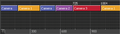

Selecting multiple camera switches
You can select multiple camera switches to change their assigned cameras. To do so, Ctrl-click the camera switches in the Switcher timeline, and then click the camera’s color box in the Camera Colors area.
Multiple cut selection
