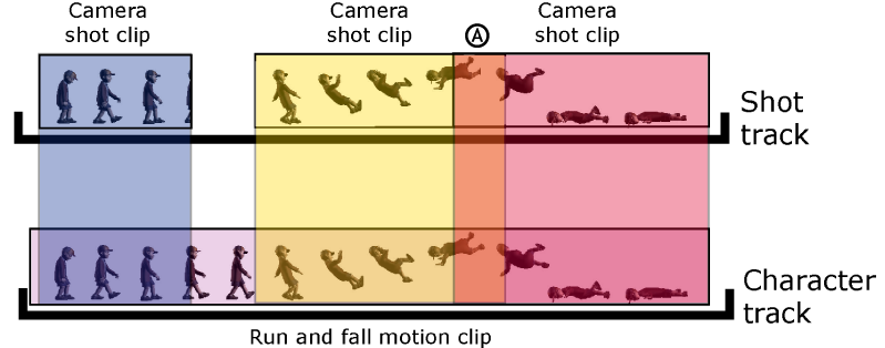

Once you have built a scene using clips in the Story window, you can use camera shot clips to edit the result on the Story window’s Edit timeline.
Camera shots on the Edit timeline covering the corresponding areas of the action on the Character track on the Action timeline A. Two camera shots blended creating a cross dissolve
You can also use shot clips to create storyboards with Camera Back Plates, or edit your how scene is filmed without changing what is set up along the Action timeline.
