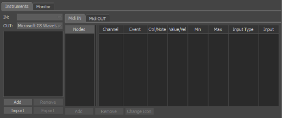

Within MotionBuilder, you need to add at least one MIDI device to connect to external MIDI hardware. Each piece of external MIDI hardware is represented in the MIDI device as an instrument.
To control external MIDI hardware from MotionBuilder or to control models, lights, and cameras in your scene using external MIDI hardware, you need to add a MIDI device, add instruments (Instrument list), then add and define inputs and outputs (MIDI IN and MIDI OUT panes).
