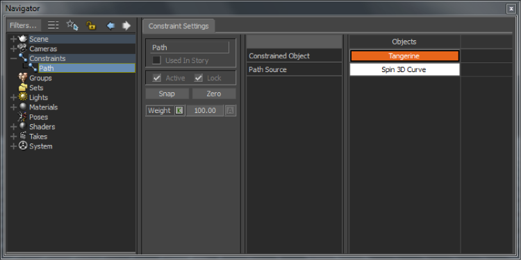

The Path constraint requires the following objects:
Assign the object that you want to follow the 3D Path to this cell.
Assign the 3D Curve that you want to use as a path to this cell.

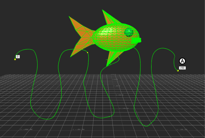

The duration of the path animation is determined by the time set in the Transport Controls End field. For example, if the End field has a value of 300 frames, the object takes 300 frames to travel to the end-point of the path.
A model with the Path constraint added. A. The duration appears in a white field at either end of the path.
