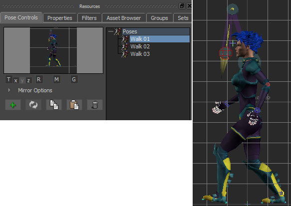

To mirror the first pose:
). The Walk 01 pose is pasted and mirrored onto Mia. Because you mirror-pasted the pose, the left leg is now forward, and the right leg is behind to continue the walk cycle on the other side.
Frame 12: First pose for the second half of the walk cycle

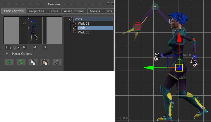

To mirror the second pose:
The Walk 02 pose is pasted and mirrored onto Mia. The result should be similar to the following figure.
Frame 16: Second pose for the second half of the walk cycle

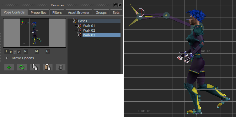

To mirror the third pose:
The Walk 03 pose is pasted and mirrored onto Mia. The result should be similar to the following figure.
Frame 20: Third pose for the second half of the walk cycle
