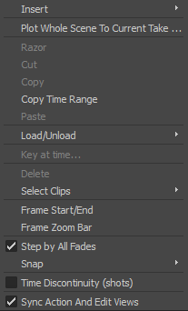

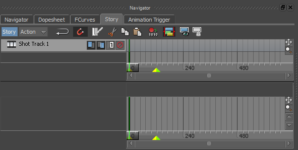

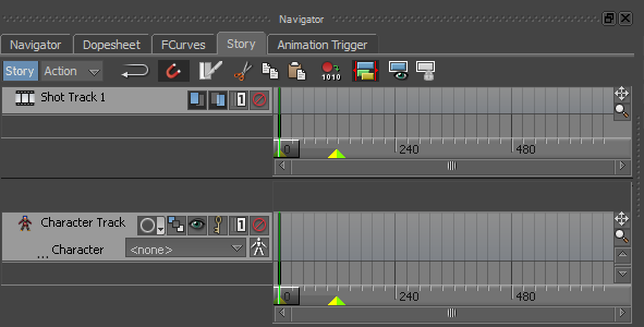

To add a Character track:
See Prepare the scene.
Navigator window Story
Action Track context menu
Character Animation Track.
A Character Track is added in the Story window Action Track.
Notice there is no Character (<none>) selected for the Character Track.

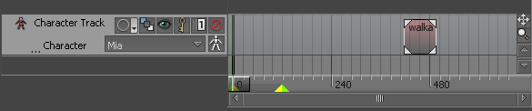

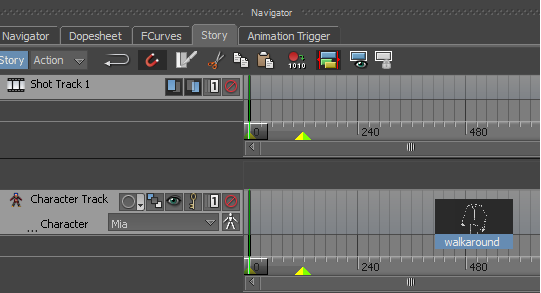

To define the Character affected by the Character Track:

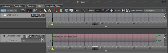

The walkaround clip is added to the Character Track.
Transport Controls A. Time Format field
The values at the top left and right of the Walkaround clip (number "0" and number "78") indicate at what frame the clip starts and ends and the values at the bottom left and right of the Walkaround clip (number "0" and number "78") identify the original clip's start and end. Since the clip has not been modified, the top and bottom values are identical.
The number "78" at the top right of the Walkaround clip indicates at what frame number the clip ends and the number "78" at the bottom right of the Walkaround clip indicates the duration (in frames) of the Walkaround clip.

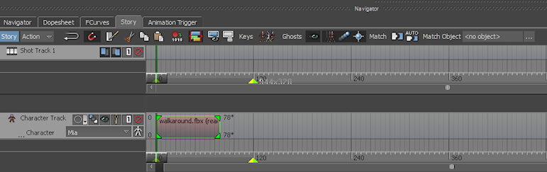

) or use the keyboard shortcut
Shift-drag to pan the
Character Track.
Ctrl-drag to zoom in and out of the
Character Track.

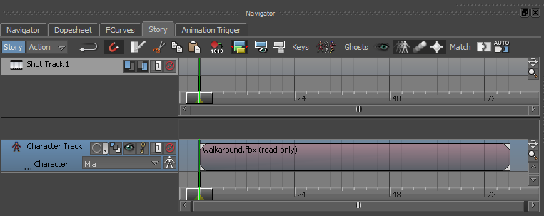

After framing the Walkaround clip, the Character Track is highlighted in blue indicating it is selected, and the Walkaround clip is no longer shown as being selected.

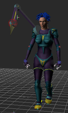

At frame 0, the Mia’s right foot is in front and the left foot is in back. At frame 32, Mia’s right foot is flat on the ground and her left foot is slightly lifted. At frame 60, Mia is in almost in the same pose as she was at frame 32. At frame 78, Mia is turned. If you were to loop the animation at this point, there would be a jump in the walk cycle.
To add animation:
The following figure shows the default view (set to Producer Perspective) was orbited to show Mia from the front.
Mia at frame 32 shown in Producer Perspective View
