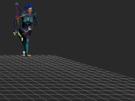

In the Viewer window, a model named Mia – with a "Servo arm" Character extension – appears to be running.

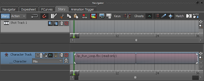

The Clip_Run_Loop is displayed in the Character Track.

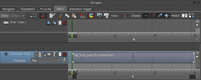

After framing the Clip_Run_Loop.fbx clip, the Character Track is highlighted in blue indicating it is selected, and the Clip_Run_Loop.fbx clip is no longer shown as being selected.
 ). When the Story mode option is activated (  ), the Story window is activated and you can select either the Story Action or Story Edit mode.
When the Story mode option is activated, the animation in the Story window can override or blend with the take selected in the Transport Controls window.
In the Viewer window, a red vector is displayed on what appears to be Mia's running path.
This vector is the clip's ghost vector. It is displayed because the Character Track's Ghost Visibility option (  ) in the Character Track menu is activated.
Character Track menu shows the Ghost Visibility option activated
