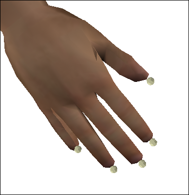

When you characterize your character, toe tips are automatically placed at the end of the model’s toes, specified by the last joint or bone. To ensure toe tips work properly, you must specify an end joint or bone as the last node in each toe.
Right hand finger tips
