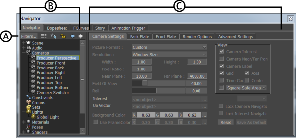

The Navigator window lets you view the hierarchy of your scene, search for character elements and objects in your scene, view relationships between assets, and edit the settings of an asset.
Navigator window A. View options B. Scene Browser C. Asset Settings area
You can add many Navigators, Scene Browsers, and Asset Settings windows to MotionBuilder from the Window menu.
