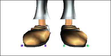

Green and blue markers around the feet of a character

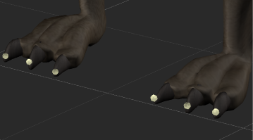

Finger tips of a quadruped character
