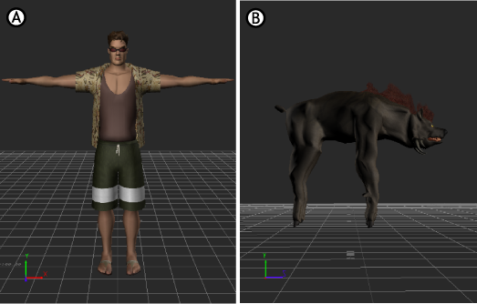

Before you characterize a model, it must be in a T-stance or rest pose, and it must be facing the positive Z-axis.
Stances A. Biped T-stance B. Quadruped stance
This stance is important because when you characterize a model, MotionBuilder takes the current pose of the model as the starting pose. All future movement is based on this starting pose.
The T-stance (or rest pose) is often used as the default position for a character. For example, Ragdoll solves recommend that characters are in the T-stance for pose matching.
To put your character in the T-stance:
> Edit > Controls > Stance Pose. The character assumes a T-stance position.
