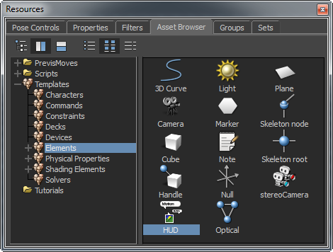

The HUD is available as an asset in the Asset Browser > Templates > Elements sub-directory.
You need to add the HUD asset in the Asset Browser to a camera or a scene. Only then, you can add a HUD element to the HUD asset and display the information in the element in the Viewer.

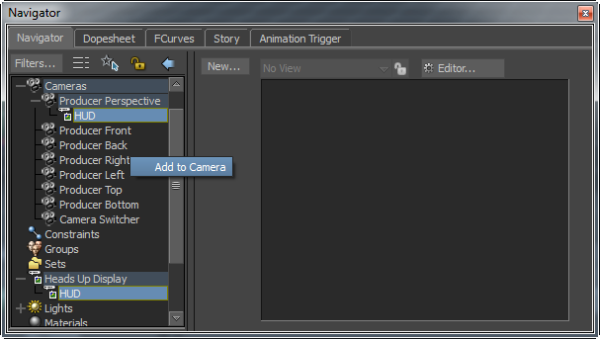

To add a HUD asset from the scene or a camera to another camera:
  1. Drag a HUD asset from the scene or a camera onto the desired camera.
  2. Click the Add to Camera context menu option.

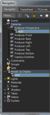

To delete a HUD asset from the scene or a camera:
  1. Right-click on the HUD asset in the scene or a camera.
  2. From the context menu, select Delete.
    If the HUD asset in a camera is a parent of another HUD asset in the scene and vice versa, then both the HUD assets are deleted.
    Tip: Clicking a HUD asset, in the scene or in a camera, highlights its parent or child HUD asset. This helps to know whether a HUD asset that you want to delete is independent or attached to another HUD asset.

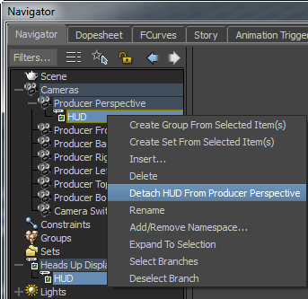

To detach a HUD asset from a camera:
  1. Right-click on the HUD asset in a camera.
  2. From the context menu, select Detach HUD From <camera_name>.
    The <camera_name> displays the name of the camera to which the HUD asset belongs.
    Selecting the Detach HUD From <camera_name> option detaches the HUD asset only from the camera, even though it contains a child HUD asset in the scene.
