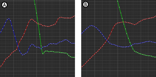

Like the Smooth filter, Smooth Translation averages all keyframes to smooth movement. Smooth Translation also smoothes the curve motion by reducing the shaking of data.
Smooth Translation A. Original curves B. Smooth Translation applied
