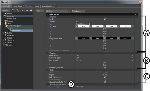

The properties of HUD element are useful to modify the appearance, position, and size of the content it displays in the Viewer. When you click a HUD element under a HUD asset, the element properties appear in the right pane of the Navigator window.
The HUD element properties are organized into four categories.
A. Display B. Position C. Scale D. Property References
The following tables explain each property within the Display, Position, and Scale category:
