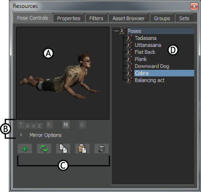

The Pose Controls enable you to create a library of poses you can copy and paste between characters (or objects) or onto a single character.
Pose Controls. A. Pose thumbnail B. Match options C. Create, Update, Copy, Paste, Delete pose functions D. Pose browser
To show the Pose Controls window, select Pose Controls from the Window menu, or use a layout in which the Pose Controls window displays.
