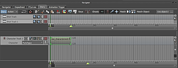

The Story controls that display change depending on what is currently selected. For example, the Clips and Edit options are always shown, but the Keys and Ghosts options appear only if a Animation, Camera Animation, or Character track is selected.
Story window displaying Shot and Character track controls

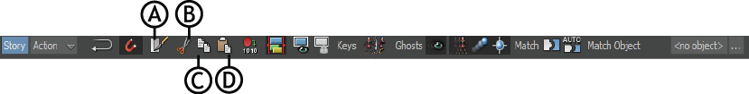

Edit buttons
Lets you slice, cut, copy and paste clips.
Edit buttons A. Razor B. Cut C. Copy D. Paste
Button Function
Razor Lets you slice a selected clip in two.
Note: To slice selected clips on multiple tracks at the same time, place the Timeline indicator over the clips and use the Razor option in the context menu instead. See Razoring clips.
Cut Removes selected clips and stores them in memory. You can also use the keyboard short-cut Ctrl-X to cut selected clips.
Copy The Copy button copies selected clips. You can also use the keyboard short-cut Ctrl-C to copy selected clips.
Paste Inserts a copied or cut selection into another location.

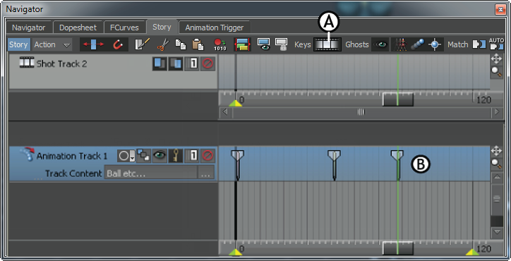

Multiple Clips option
The Multiple Clips option displays when an Animation, Camera Animation, or Character track is selected.
When the Multiple Clips option is active, clips are automatically created along the track as you move the Timeline indicator and transform selected assets. A clip is created for each keyframe.
Story window A. Multiple Clips option set to active B. Clips created for keyframes at frame 0, 49, and 81
Note: The color of the clips on the track represent the keyframes they represent.

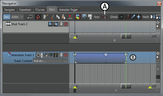

When the Multiple Clips option is disabled, only one clip is created when you transform selected assets. When the option is disabled, the clip stretches to include the keyframes you set.
Story window A. Multiple Clips option disabled B. Clip encompassing keyframes at frame 0, 49, and 81

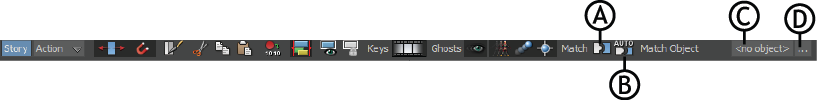

Match Controls
The Match Controls let you blend animation between clips and tracks smoothly. You can match a selected clip to the clip that comes before or after it. You can also match more than one clip at once by selecting all but the first clip.
Story controls A. Match Options button B. Auto Match option C. Match Object field D. Match Object button
The Match Controls are active only when an animation, camera animation, or character clip is selected. See Matching clips for more information.
