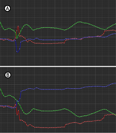

Unroll rotations filter A. Original curves B. Unroll Rotations applied
When you select the Unroll Rotations filter in the Filters window, you can set the following parameters:
Lets you manipulate the algorithm that affects the path of rotation curves. The default value (.25) concentrates on the Y curve path. Tweak the Quality value to manipulate the path of the X, Y, and Z rotation curves.
Select Path to enable the Quality field. When Path is disabled, the Unroll Rotations filter searches for and cleans sudden jumps in the Y rotation curves.
