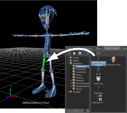

X-Ray mode lets you see through the character skin to the skeleton underneath.
3ds Max Biped Template asset applied to the Character skeleton
The 3ds Max Biped template is specially designed for bipeds created in 3ds Max as they have a different naming structure that the MotionBuilder Character does not recognize automatically.
The Character representation shows green if the characterization is correct, yellow if potential problems are detected, and red if there is an element of the skeleton matching that is incorrect.

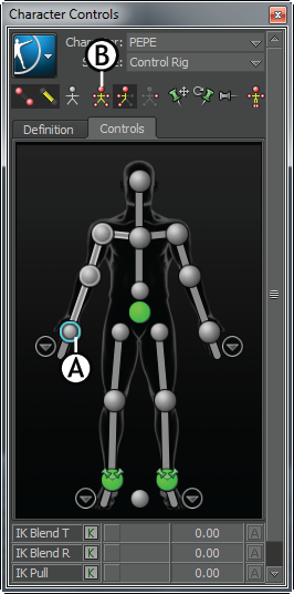

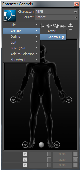

You must use the Control Rig Input setting if you intend use keyframe animation on your biped.
FK/IK is the method commonly used to animate characters.
A. Ctrl Rig selected B. Effectors appear on the character
Character Controls A. Right Wrist effector selected B. Full Body icon

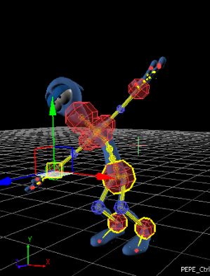

The transformation handles display.
As you move the hand, the arm extends and the rest of the body follows in a natural movement.
You can now animate your character with motion capture and key frame animation.
