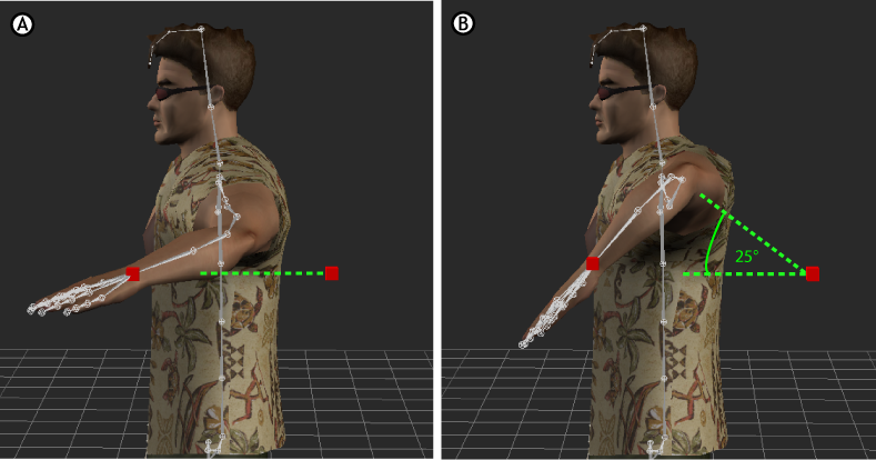

Use this setting to offset the Pole relative to the Pole object’s position. You can use more than one Pole Vector object to create an offset. See Multiple Pole Vector objects.
Pole Vector offset A. No offset B. Y-value offset to 25 degrees
