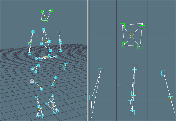

Optical data are sets of translation data. This data consists of many different points with only translations and no rotation or scale data.

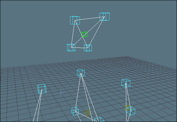

Selected four markers define the head Rigid body
Center Rigid body marker indicating rotation
Rigid bodies are also an important part of correcting occlusion and partial occlusion. Since an occluded or unlabeled marker is connected to other optical markers, the optical system attempts to calculate the position of the occluded marker based on the other markers in the Rigid body. This calculation may not be sufficiently accurate and may need to be corrected manually.
