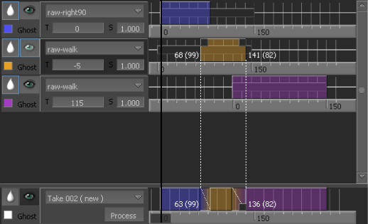

You should add one track for each take you want to blend. For example, if you are blending two parts of the same take, add one track for each part. Both tracks use the same take.
For example, if you are blending two takes using one cut from the “raw-right90” take and two cuts from the “raw-walk” take, you should have three tracks in total: one track for “raw-right90” and two tracks for “raw-walk”.
Two takes blended using three tracks
