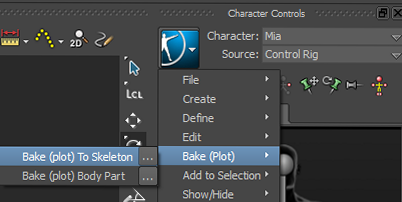

To Bake (Plot) all the animation on the BaseAnimation layer:
Bake (Plot)
and click
for the Bake (plot) to Skeleton menu option.

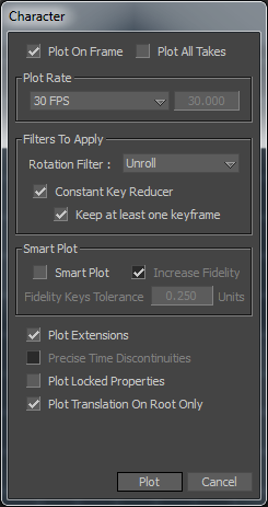

The Character dialog displays.

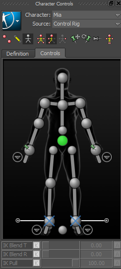

All the animation data is transferred from the Control rig to the character’s skeleton on the BaseAnimation layer of the current take.
Numerous green keyframes display on the Transport Controls timeline.
You can also see your plotted data in the FCurves window as a series of function curves with numerous keyframes.
The animation of the Mia's Servo arm rising up and Mia's head turning are merged with the original animation of Mia running and turning around.
