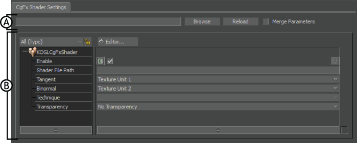

The CgFX shader settings are split into two parts, the Shader area, and the Shader properties.
The Shader area displays the name of the .fx file in the Name field. Click Browse to open a file browser and locate an .fx file, then click Reload to refresh the CgFX shader’s appearance.
When loading or reloading CgFX shaders, activate the Merge Parameters option to keep the shader’s property settings and references to .dds files. Disable the option to clear these settings when you load or reload CgFX shaders.
CgFX shader settings A. Shader area B. Shader properties
