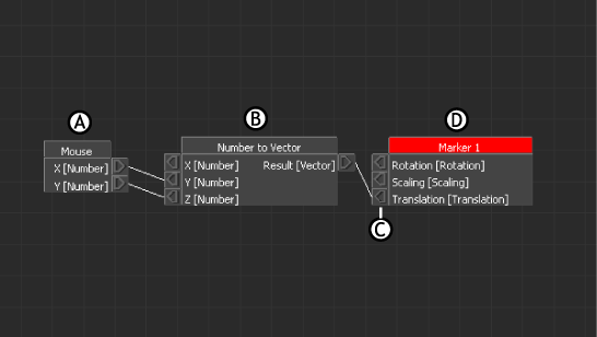

Relations constraint A. Sender B. Operator C. Connector D. Receiver
A Relations constraint consists of at least two objects. One object transmits data (Sender) while the other object interprets the sent data (Receiver).
For example, the relation in maps the movement of the mouse to a marker. Between the Sender and Receiver, an Operator converts the numerical data from the mouse to a vector for use by the marker. Operators are used to perform mathematical operations, comparisons, or conversions.
The Sender object can be an input device, such as a mouse, and the Receiver object data can be a model, light, or output device. See Connecting Senders, Operators, and Receivers for information on how to connect input and output boxes.
