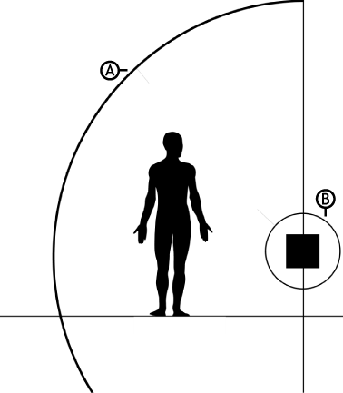

A. External Range limit B. Internal Range limit
The magnetic field is very strong; it is approximately 1.5 feet around all emitters. If the calibration pole or a wired performer stands within this area (Internal Range Limit), it is impossible for the position of the magnetic sensors to be accurately captured.
The magnetic field from the emitter also has a physical range (External Range Limit). If the calibration pole or a wired performer gets too close to the limit or moves outside the range, the position of the sensors cannot be properly captured.

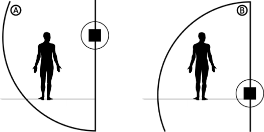

A. Emitter is too high. The performer’s feet may not be captured. B. Emitter is too low. The performer’s hands may not be captured if they are raised over the head. Even more may be lost if the performer jumps.

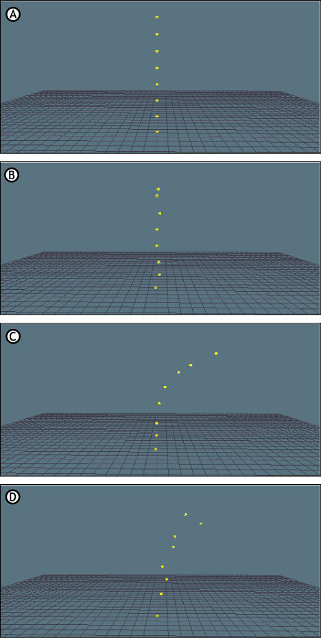

To test the area, MotionBuilder must be running and the appropriate magnetic device must be added and set up. Then move the pole around the edge of the proposed capture area and around arbitrary locations within the capture area. While you move the pole, watch the Viewer window to see how sensors react to your proposed capture area.
A. Ideal capture B. Suitable capture C. Limited capture D. Poor capture
