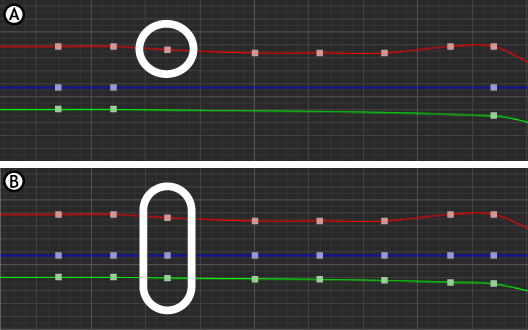

Adds a keyframe to all curves (X, Y, Z) for each key that is encountered . For example, if a light has a keyframe set on its X translation function curve, a keyframe is set on its Y and Z translation curves at exactly the same time. This synchronizes all keyframes on each of the object’s function curves.
Key synchronizing A. Original curve B. Key Sync applied
