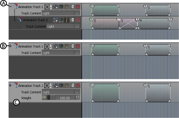

In the Story window, every time you insert a track, track controls appear in the Action Track list.
These Action Track controls let you move, stretch, expand, and collapse tracks. They also let you select animation options, hide or show ghosts, and activate or disable tracks.
The Track Controls change depending on what track you have. For example, all tracks have Solo and Mute buttons, but only a Character track has a Character menu.
You can expand and collapse folders and tracks when you have a hierarchy of folders, tracks, or subtracks.
To hide or show the selected track’s subtracks, click the Collapse/Expand (- +) button (A and B) located at the upper left of the Track controls. Collapse and expand tracks when you use multiple hierarchies of tracks, or do not want to view all tracks simultaneously. See Insert Subtrack for more information on creating track hierarchies.
Tracks A. Collapse symbol B. Expand symbol C. Stretch track

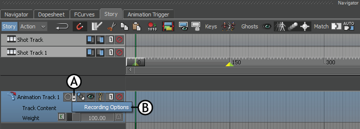

Animation Track Recording options window for that specific track appears. In this window, by default, the
Always display checkbox is turned on. If you turn this checkbox off, then in your next session, you cannot invoke the
Animation Track Recording options window by clicking the
Record Mode button.
Animation Track Recording options window A. Always display checkbox turned on by default
The Record Mode menu includes the Recording Options.
Navigator window A. Drop-down list button B. Recording Options menu option

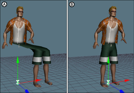

| Clip Offset | When you disable Clip Offset, the clip trajectories are locked in their original location. If you activate Clip Offset, you can translate and rotate clip trajectories in the Viewer window. Clip Offset is useful when you need to keep part of a model in its original location. For example, when only a character’s upper body is selected in a track, translating the track’s clips stretches the character’s body apart unnaturally. The character’s upper body is translated but the lower body is left behind. To keep this from happening, disable the Clip Offset option. If you want to use the Clip Offset option but freeze the clip vector in a location, you can move the clip vector, save the clip, then enable Clip Offset. The Clip Offset option displays in the Track Options of Animation, Character, and Camera Animation tracks, as well as the Asset Settings window. |

Using Clip offset A. When Clip offset is active, translating clips can create unwanted results B. When Clip offset is disabled, clips remain in their original position and cannot be translated or rotated.

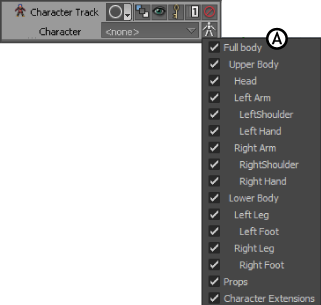

Track Controls A. Character menu
Use the Body Parts menu to select the parts of the character that are to be used in the animation. Use the menu to also select or deselect any character extensions or props included as track content.
Track Controls A. Body Parts menu
For example, when only Right Arm and Right Hand are selected in the menu, you can only transform and animate the character’s right arm and hand. No other body part moves from its original location.
Selecting only a few parts of a character’s body also lets you create local blends. A local blend consists of replacing the motion in one track with motion from another track on only part of a hierarchy. For example, blending the lower body of a running character with the upper body of a waving character to create animation of a character running and waving at the same time.

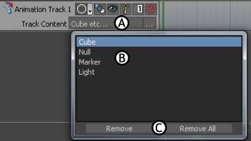

The Track Content list displays the name of the asset that you drag onto an Animation, Character, or Camera Animation track. A track’s clips affect the asset selected in the Track Content list. These selected assets are often referred to as the track content.
Animation track A. Track Content list B. Click on the list to see what you dragged into the track. C. Remove button
Animation track A. Track Content button B. Asset list
You can also find the Track Content list in the Asset Settings window when you double-click an Animation, Character, or Camera Animation track.
