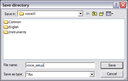

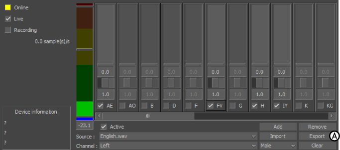

To save a Voice device setup:
Voice device settings A. Export button
The Save directory dialog box appears.
The Voice device setup is saved in the .fbx file format.

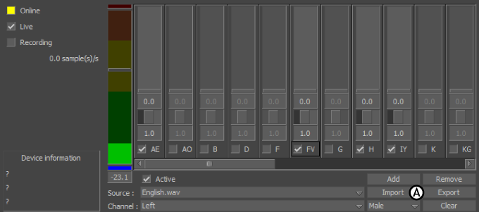

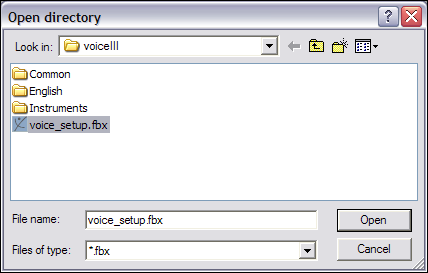

To load a Voice setup:
Voice device settings A. Import button
The Open Directory dialog box appears.
Open directory dialog box
