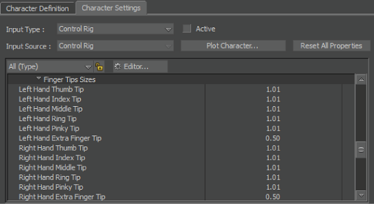

In the Character Settings pane, the options within the Floor Contacts > Fingers Floor Contact Setup folder let you adjust how fingers make contact with the floor.
Lets you choose the behavior of the fingers as they contact the floor. There are three behaviors you can choose from:
| Option | Behavior |
| Sticky | Each finger sticks to the floor exactly where contact is made. |
| Spread | Spreads the fingers as they make contact with the floor, attempting to keep the position of the fingers intact. Rotation is applied to the root of each finger. |
| Sticky & Spread | Averages the finger behavior between Sticky and Spread. |
Corrects unnatural finger rotation when finger floor markers contact the floor. At 100%, Fingers Contact Roll Stiffness attempts to prevent the fingers from rotating in unnatural directions.
Finger Tips Sizes group of properties
