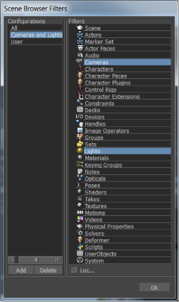

To create Scene Browser configurations:
The Scene Browser Filters dialog box appears.
In the Configurations pane, a new configuration is added with the default name New_Config.
In the Filters pane, by default, all assets are selected for adding to a new configuration.
Scene Browser Filters dialog box.

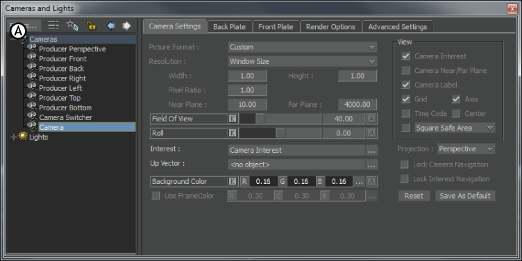

The name of the new Scene Browser configuration displays in the title bar of the Navigator window. If the Navigator displays within a tabbed window, a tab displays the name of the Scene Browser configuration. For example, the following figure shows the Navigator using a configuration named Cameras and Lights.
Cameras and Lights filtered Navigator window A. Cameras and Lights appears in the title bar and in the Navigator tab

The Scene Browser Filters dialog box appears. See Scene browser Filters dialog box.
