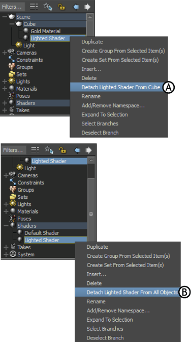

Lets you detach all assets from a model or other asset with materials, textures, and shaders. This menu item changes depending on the selected assets and where you right-click.
Right-click a material, texture, or shader in the Scene folder to detach the asset from its parent. For example, if you right-click a shader attached to a cube, the context menu item asks if you want to detach the shader from the cube.
Right-click a material, texture, or shader in its dedicated folder to detach the asset from all attached objects. For example, right-clicking a shader in the Shaders folder displays a menu option that lets you detach the shader from all attached objects.
A. Detach From Asset B. Detach From all Objects

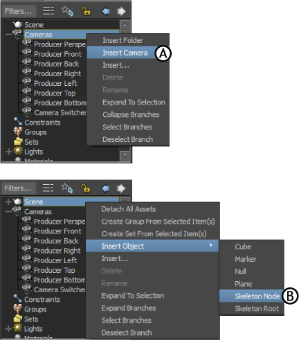

Lets you add an asset to your scene where <asset> matches the folder that you right-click.
For example, right-clicking the Cameras folder lets you add a custom camera, while right-clicking the Scene folder provides an additional submenu, letting you add any object.
Insert <asset> A. Insert Camera B. Insert Object

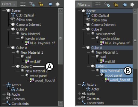

Selects or deselects all the assets connected to the branch that you right-click. For example, right-clicking on a cube and choosing Select Branch selects the cube and its child assets.
Select Branch A. Right-click on Cube C and choose Select Branch. B. Cube C and all its child assets are selected.
You can also use Select Branch and Unselect Branch with Asset folders. For example, you can right-click the Textures folder and choose Select Branch to select all the textures in your scene.
