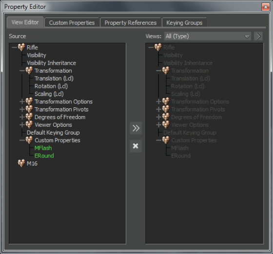

The Property Editor lets you create custom views, custom properties, property references, and custom keying groups.
You can access the Property Editor by clicking the Editor button in the Properties window or by going to the Window menu and selecting Add Property Editor.
