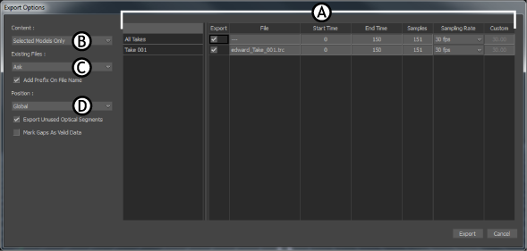

Export Options dialog box with two takes A. Export Table B. Content area C. Existing Files area D. Additional Export Options
The Export Options dialog box is split into the following areas:
The options that appear in the Export options dialog box depend on the file format you exporting to. When you export a motion file, there are two main considerations:
