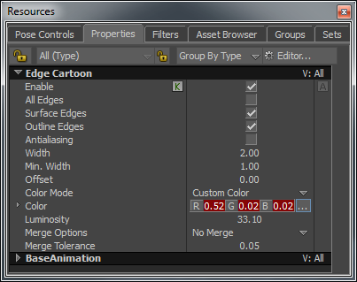

To disable a shader via the Properties Resources window:
- In the Navigator Scene browser, expand the Shaders group and select the shader you want to disable.
- In the Resources window, select the Properties tab.
The shader's Enable option is activated.
Properties window A. Edge Cartoon shader shown Enabled
- Disable the Enable option.

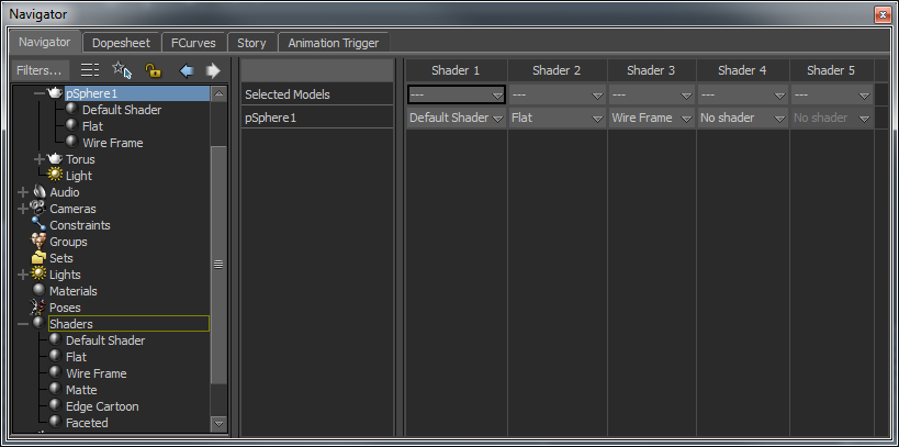

- In the Navigator window Scene browser, expand the desired object to view its contents.

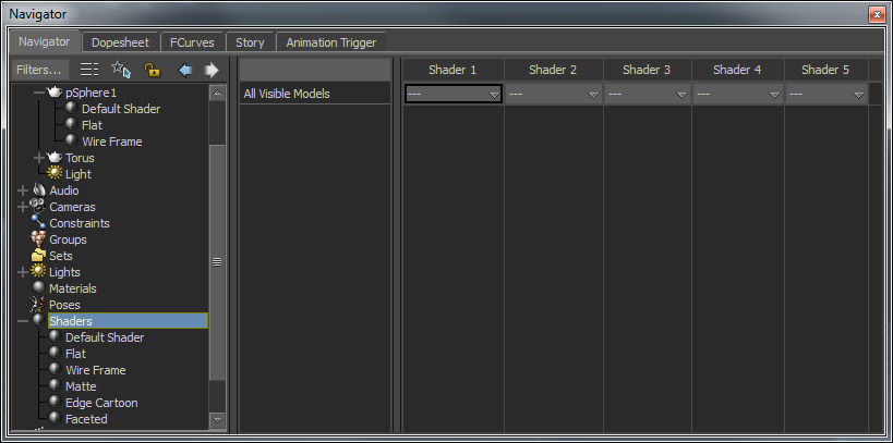

- Double-click the Shaders folder to expand its contents and access the Shader Manager.
The Shader Manager displays a column for each shader in the Shaders folder with the exception of the Default Shader.
Shader Manager displaying a column for each shader used in the scene
- In the Navigator window Scene browser, select the desired object to display the object and its shaders in the Shader Manager.
The Shader Manager displays the selected object and its shaders.
The shaders appear under each column in the same order as they appear under the selected object in the Navigator Scene browser.

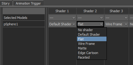

- In the Shader Manager, click the Shader you want to detach.
A context menu displays the list of shaders used in the scene.
- Select No shader.

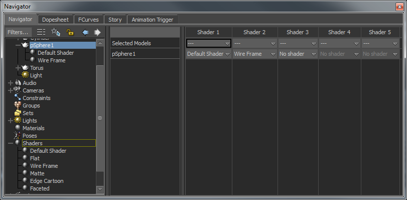

In the Navigator window Scene browser, the shader is detached from the selected object.
In the Shader Manager, the selected shader is replaced by "No shader" and the Shader columns update to replicate the order of the shaders applied to the selected object.

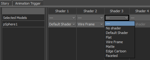

- In the Shader Manager, in the Selected Models row, go to the desired Shader column and click the menu.
- Select the desired shader to attache to the object.
The shader is displayed in the selected Shader manager column and under the selected object in the Navigator window Scene browser.
