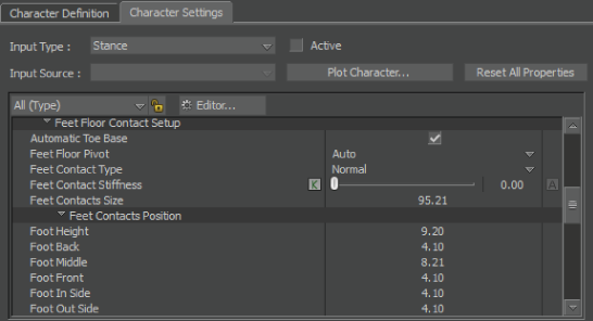

In the Floor Contact group of character properties, the Feet Floor Contact Setup properties let you adjust how feet make contact with the floor.
The Feet Floor Contact options are similar to the options in the Hands Floor Contact group.
Corrects the feet but does not let you manipulate each toe base. This option is disabled by default when you create a character so that you can manually manipulate and animate each toe base.
When Automatic Toe Base is active, you cannot animate each toe base, but you can still keyframe the result positions provided by the floor contact.
To take full advantage of the solving from the toe base of each foot, it is recommended that when you create the skeleton of your model that the toe base should be the parent of each toe. For the big toe, you should use the extra toe.
Use the Feet Floor Pivot to select the pivot of the foot when it makes contact with the floor. The following table describes the three Feet Floor Pivot options:

The Feet Contact type lets you define the number and orientation of markers used to define the floor contact for the feet of your character. The four types of feet contact are described in the following table:

Lets you define how stiff the foot becomes as soon as any part of the foot contacts the floor.
Lets you change the size of the contact markers that outline each foot. The center of the contact markers is the point used for floor contact. Increasing the Feet Contacts Size only makes the floor contact markers more visible, it does not affect the way the feet contact the floor. To view the contact markers for both hands and feet, select

Feet Contacts position properties
Each Feet Contacts Position setting defines a different aspect of the foot contact area. These settings are described in the following table:
