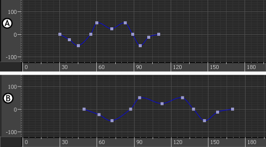

Time shift and scale A. Original curve B. Time Shift and Scale applied
When you select the Time Shift and Scale filter in the Filters window, you can set the following parameters:
Lets you select the number of frames by which you want to shift (offset in time) the curve.
Lets you select the scaling factor. This option only scales time, not value.
