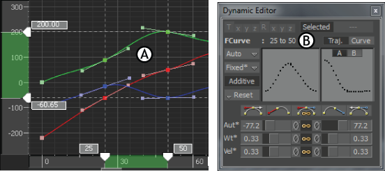

If you select one or more keyframes in the FCurves window, the Dynamic Editor indicates this and only the selected keyframes are modified.
Editing keyframes A. Six keyframes selected in the FCurves window B. Dynamic Editor indicating only the keyframes selected in the FCurves window are modified

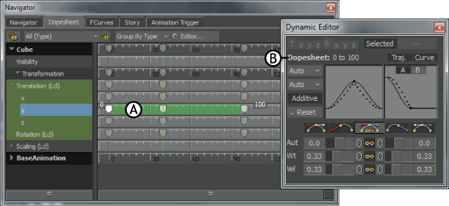

The Dynamic Editor also indicates that keyframes are selected in the Dopesheet window and only the selected keyframes are modified.
Editing keyframes A. Three keyframes selected in the Dopesheet window B. The Dynamic Editor indicating only the keyframes selected in the Dopesheet window are modified
