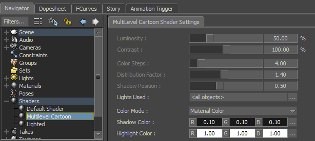

The Multilevel Cartoon shader lets you apply a posterized effect with full control over the luminosity, contrast, and number of steps in the gradient between the shadow and highlight colors.
The Flash Renderer only supports up to four Color Steps between the Shadow Color and Highlight Color. If you specify more than four steps, the gradient between the Shadow and Highlight Color adjusts automatically to only four steps.
MultiLevel Cartoon Shader Settings
For the best results, use two or three steps, with increased steps resulting in a complex rendering of the .swf file.
