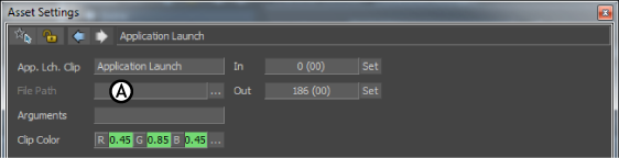

The File Path field displays in the Asset Settings window when an Application Launch command clip is selected. The File Path field lets you choose the application you want to launch when the command clip plays.
You can type the path in the field, or you can click the browse (...) button beside the field to locate the file.
Common clip settings A. File Path field

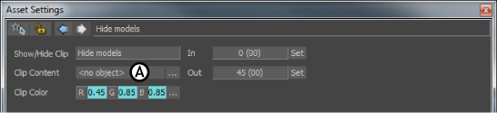

The Clip Content field lets you assign assets to Hide command and Show command clips. When you drag a Hide Models or Show Models asset from the Command folder in the Asset browser to the Story window, the new command clip that appears displays the name of the command followed by a <No models> message.
To assign a model to a Show Models or Hide Models command clip, select a model from the Viewer window and Alt-drag it into the Clip Content. You can also Alt-drag models from the Scene browser or from the Schematic view in the Viewer window.
Common clip settings A. Clip Content field

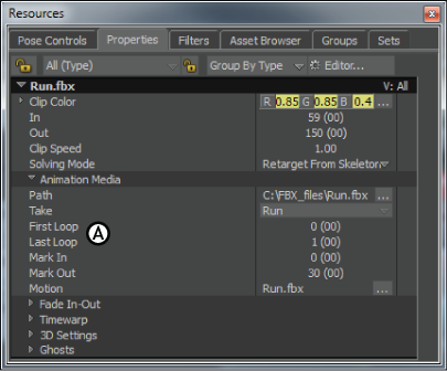

The First Loop field lets you determine at which part of a clip the loop begins. The field uses the local time of the selected clip. You can loop every type of clip except command and constraint clips.
When you use the First Loop field, the first loop can be of a different length than the loops in the rest of the clip.
Looping clip A. First loop B. Mark In C. Mark Out D. Last loop
Properties window A. Last Loop field
