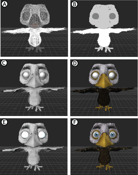

Models Display
The Models Display menu option contains global shading options that apply to the entire scene.
Models Display options A. Wireframe B. Flat C. Lighted D. Shaded E. Textured F. Shaded & Textured
The Models Display menu options are:
Description
Wireframe
Displays selected objects as wireframe.
Flat
Displays selected objects using a constant color. This option ignores light sources in a scene, and overrides any custom shading, textures, and materials applied using the Shader settings. See About shaders.
Lighted
Displays selected objects using their custom shaders created in the Shader settings. Textures do not display.
Textures
Displays selected objects with their applied textures. This option is available only when the Lighted option is selected, in which case Use Textures is active by default. See Textures.
Shaders
Displays selected objects using the default shader. This option is available only when the Lighted option is selected, in which case Use Shaders is active by default.
Textures + Shaders
Displays selected objects with both the default shader and their applied textures.
