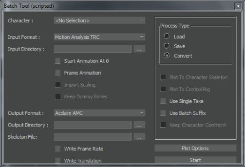

The Tool Manager displays the tool scripts available in the PythonStartup folder. In the following figure, the Tool Manager displays the CharacterSelection/Key Controls tool script (CharacterSelectAndKey.py) and the Batch Tool script (BatchTool.py).

Batch Tool script
